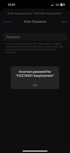

I did a factory reset on my wifi and now I am not able to connect any device on my wifi to set it up.

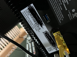

When I try the default key it shows incorrect password
When I look in the available wifi list, only "FIZZ74551-EasyConnect" is visible and on my modem, my default wifi network is: FIZZ74551; and its nowhere to be found.

    Try this,
    • do another reset
    • wait 15 minutes
    • in the meantime, forget all the fizz network on your device
    • after 15 minutes try to connect, for the password sometime en I the lower case "L" was an uppercase "i" or a 1. Try that
